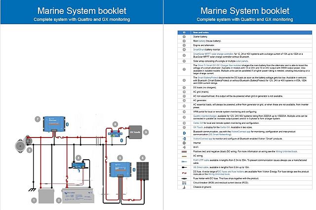

I'm also planning a lithium install. a 300amp LiFePo and an AGM starter. I plan on using the OEM alternator with a DC to DC charger from Victron and limit it to 30 amps. I'll have 400 watts of solar through a Victron controller. Also a Victron smart shunt to monitor the system.
What I'm not sure about is where does the power from the alternator go now? Does it go to the Charles charger, the 1-2-Both switch, or the positive busbar behind the breaker panel? I think I need to route it correctly so the power goes through the DC to DC and then to the batteries.
Also wondering if the Charles charger can even be used anymore when hooked to shore power, or at all?
If anyone knows of a marine electrician that can answer questions without breaking the bank, I'd love to talk to them. I plan on using the drawing below as a guide for hook up.

- Posts: 165
Re: Lithium Batteries
Hi Ed,
I'm doing something similar..
The 30 amp Charles charger does not support lithium, so I replaced it with a 50 amp Victron charger that supports Lithium. Since I am currently using AGM batteries, they charge a little faster and I like the bluetooth monitoring. The amp meter on my Charles was not accurate, but it is also 20+ years old.
I also replaced my stock 51 amp Mando alternator years ago with one from Compass Marine rated at 105 amps and I'm using a Balmer external regulator which is also not lithium supported but works well with AGM.
I'm also running 600 watts of solar through a Victron MPPT controller that works with lithium.
Later this season, I'm going to install a Victron DC to DC charger that will input power from my alternator and output power to the lithium batteries, for the house bank, and to an AGM battery for the starter motor.
For the lithium batteries, I'm trying to find two 4D "drop in" batteries, or possibly four Group 31s that would fit in the battery locker next to the nav desk.
For the AGM starter battery and the DC to DC charger, I will put them in the large lock next to the battery locker.
I'm curious...which batteries are you looking at?
