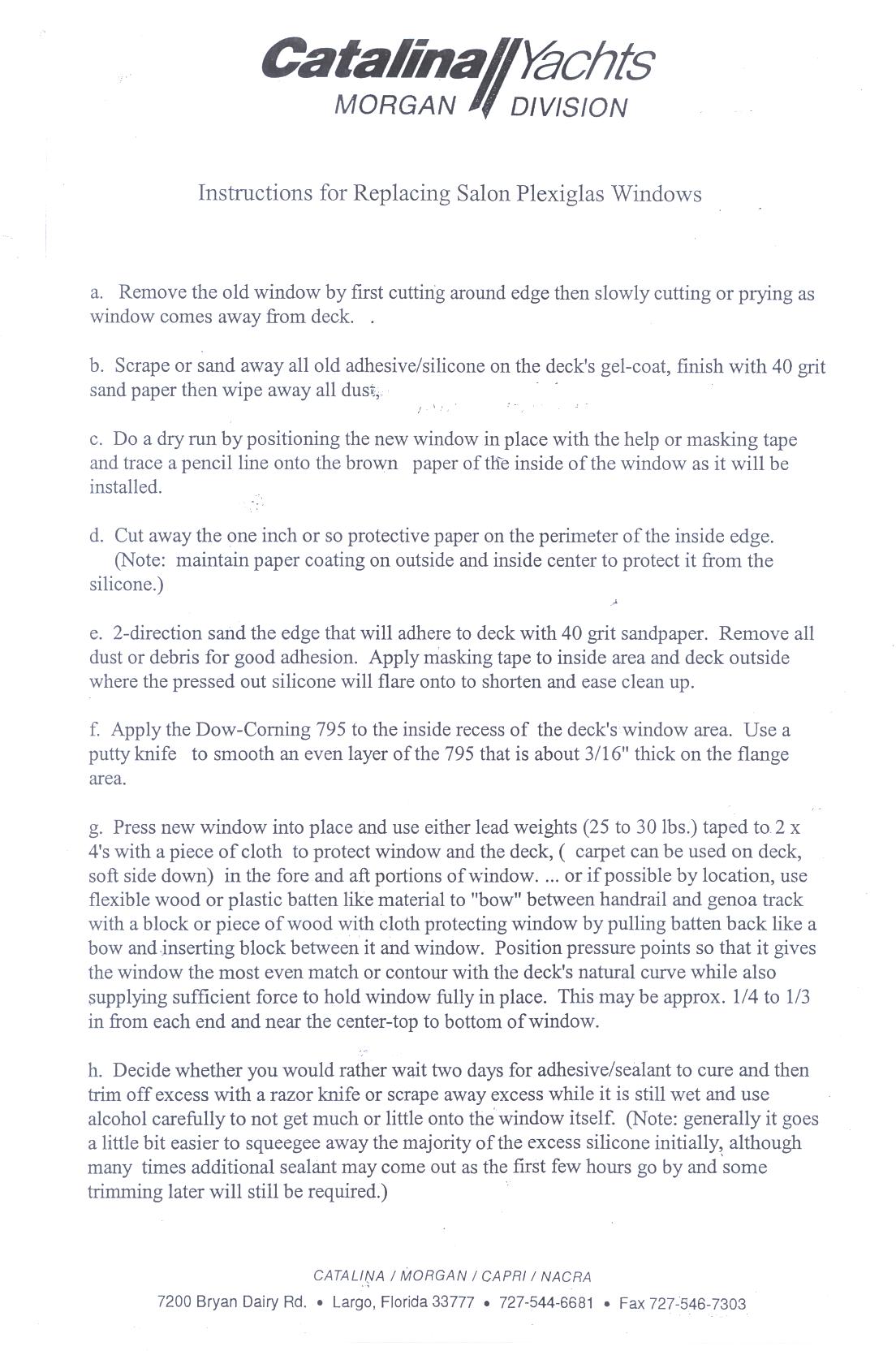

Straight from Warren Pandy....
Instructions for installation/replacing fixed salon Plexiglas sidelights.
Our port side fixed salon sidelight starting leaking. We did not remove and rebed our sidelight, but we did remove all of the old sealtant and then ran a bead of the Dow Corning 795 (BLACK). Hopefully, in the next 24 hours we will know if it repaired the leak.
- INSTRUCTIONS FOR INST. OF CABIN HOUSE WINDOWS.jpg (235.43 KiB) Viewed 10856 times

I cut away the old silicon caulk, cleaned it up real well. I ran a very small bead inside, then a larger bead outside. I then put a 25 lb lead weight in a pair of socks, and tied this to the hand rail above the window. It rested up against the window and pressed it in place while the new silicon caulk cured. Two days later, hosed it down and no more leaks.
