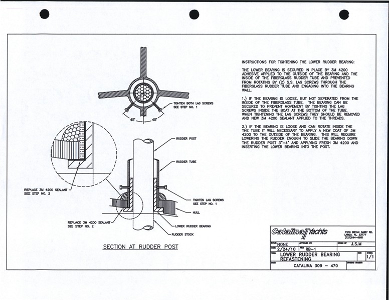

Thank you djones. FYI.......... RECEIVED SOME GREAT INFO FROM CATALINA YACHTS: Here's how to drop the rudder:
There are Typically three (two for sure) things that hold the rudder in place or keep it from dropping.
1. The top cross bolt shown in drawing that goe thru the shaft just a few inches down from the top accessible from the cockpit sterring well in floor.
2. The Edson two piece radial wheel that has 4 bolts that clamps it on to the rudder as well as one bolt that goes thru the center of the unit and thru the shaft. (look for about 5 there total until you can hold both pieces of the radial wheel in your hands like a split pizza
(After loosening the steering cables of course)
3. An optional autopliot tiller arm will also have a bolt that goes thru the shaft center.
Once these three are all removed, if you ease off your bottle jack (or boards) the rudder will come down. (rudder wieghs about 150#).
I have a drawing ("Lower Rudder Bearing Refastening" from Catalina Yachts) of the Rudder Bearing Assembly which includes step by step instruction for re-gluing the lower rudder bearing. I plan on re-gluing in the Spring of 2012 when the weather is warm enough for the adhesive to cure. I will be happy to e-mail the drawing if you need it.

- Bearing Tightening the lower bearing.JPG (99.93 KiB) Viewed 11599 times
Re: Rudder 'play' question
Diagrams
- Rudder Assembly.jpg (146.89 KiB) Viewed 11810 times
- Bearing Tightening the lower bearing.jpg (461.87 KiB) Viewed 11810 times

FYI...... I dropped the rudder, cleaned the lower bearing, used 3M-4200, put the bearing back in place, put the rudder back in place, re-installed the steering cable assembly, auto pilot. All of this took me (with no help) approximately 5 hours. This was the first time doing this project. If I have to do it again I think it would only take me 3 to 3 1/2 hours.
