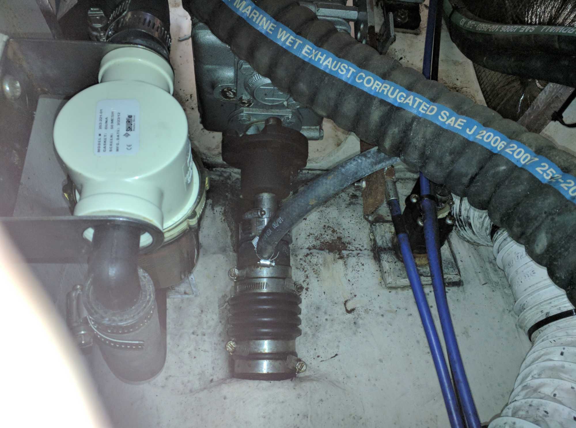

WE have just been able to take the new to us boat out a couple of times. Last time out I did notice the engine at idle up to about 1400 or so seemed like it was a bit loud.
I read about the damper plate issue and since I don't have one to compare to maybe you could give me some insight. Below is a picture of the Engine compartment on the Stbd side I noticed a bit of material (dust). You can see that in the picture.
Is this a damper issue or just normal sounding?
Thanks.
Re: Damper Replacement
Posted: Mon Aug 21, 2017 7:50 am
by dedgell
Sounds like the damper plate issue to me. Recommend you replace it and the PYI driplesd stuffing box bellows next time you haul. We just did both on hull 442 at 500 hours and it is a major improvement.

This is probably a little off topic, but is that raw water strainer just "floating" inside the large holes in that U shaped bracket or is it secured somehow? If floating, I'd be concerned about a vibration related failure over time.

roostermt,
Congratulations on your new boat.
Reality is that at an idle speed of 1,400, you can not determine if the damper is good or bad. Reduce idle speed to specs (from your engine owners manual and THEN evaluate.
Posted: Tue Aug 22, 2017 7:52 pm
by roostermt
Mark - The Strainer is indeed secure. Funny you say that though during the survey it was free floating and broken. Fixed before buying per Survey
Brett - the idle speed is set correct somewhere around 900. I was just stating the shaking and sound was prevalent from idle to about 1400.
Thanks guys for the help. Looks like I'll need to get someone out to take a look. Boat is just to new to me to know if it's a real condition or one I'm making up in the head.
